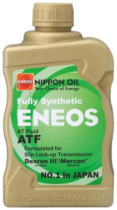

Ответ: Что лить в АКПП Култуса?
Енеос - это (помоему) минералка. На замену пошло - около 3,5-3,6 литров.
И на сколько мне известно только Мобил выпускает ATF синтетику.
Добавлено через 3 минуты
Заливал красный и жидкий. А получил слегка зеленовато-желтоватую жижу которая напоминает "жидкий кефир" который немного тянется.
ENEOS D3 вроде синтетика:
ENEOS Premium ATF D 3
Automatic Transmission Fluid
ENEOS Premium ATF D3 is a synthetic automatic transmission oil specially developed for new (after 1997) but also older (automatic) transmissions of GM and Ford, as well as many other manufacturers. It is also suitable for power steering, some hydraulic systems and rotating air compressors where an extremely good fluidity demanded at low temperatures. ENEOS Premium ATF D3has a very high viscosity index and offers resistance against corrosion and foam-building. It has also very good anti-oxidation and anti-wear characteristics. ENEOS Premium ATF D3 has an extremely low pour point which allows easy shifting of gears after a cold start. This ATF does not affect seals.
