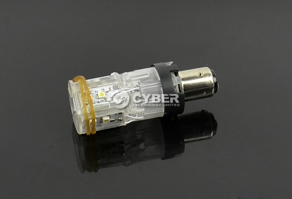

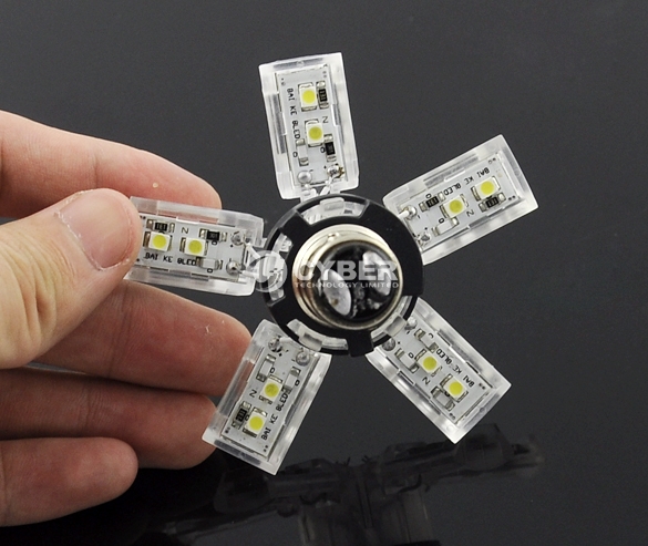

    Хочу себе в задние фонари приспособить вот такие прибамбасы: СТОП и габариты
    White 40 LED 2.4W 5050SMD Spider 5 Claws Brake Stop Turn Tail Car Light Bulb NEW
    Features:
    • 100% Brand New.
    • Shell Color: White
    • Light Color: White(6500-7000K)
    • Size: 25mm(D) x 70mm (L) / 70mm(D) x 40mm(L) (unfolded)
    • Bulb Base: 1157 BAY 15D
    • Working Voltage: 12V/24V(DC)
    • Working Consumption: 2.4W
    • SMD: 5050
    • LED Qty: 40
    • Working life: 5,0000 hours
    • Folding arms.
    • Built in with 40pcs LED. (front side: 30pcs LEDs; rear side: 10pcs LEDs).
    • Small and exquisite appearance, easy to install and use (plug and play).
    • Long service life, high luminous efficiency.
    • Energy saving, low power consumption and super bright.
    • Long durability, high shock/vibration resistant.
    • Fast on/ off response time.
    • Environmentally friendly, no light pollution.
    • Great replacement for brake light, stop light, tail light, turn signal light, parking light, backup light and so on.
    • Compatible with: 1157 (BAY15D) 1016 1034 1076 1130 1142 1152 1154 1158 1493 2057 2357 2396 2397 3496 3497 7528 12499 12594...(For Reference Only).
    • Please check the led light base type of your vehicle to confirm if the bulb will fit it.

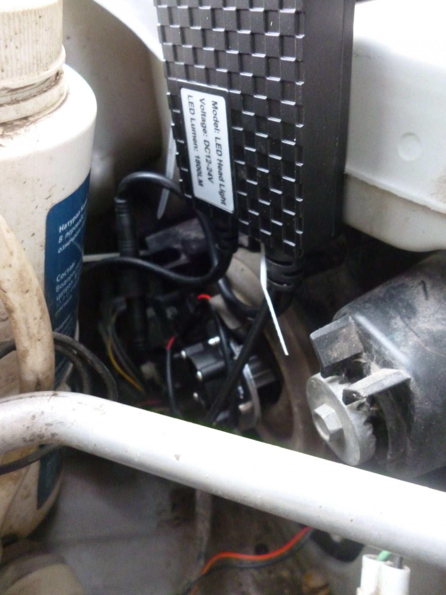

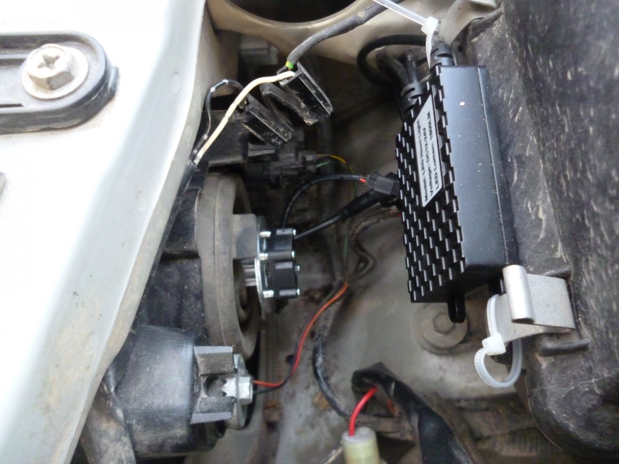

    Car H4 LED Headlight High and Low Beam LED Head lamp 6000K 1800LM 25W CREE-1512 заказал сегодня на ebay, успел за 100 баксов.
    [​IMG]
    [​IMG]
    [​IMG]

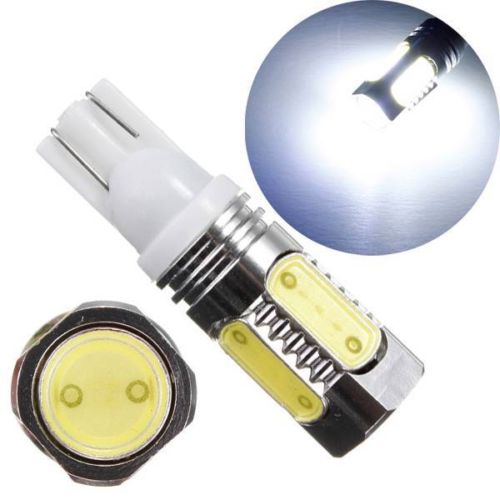

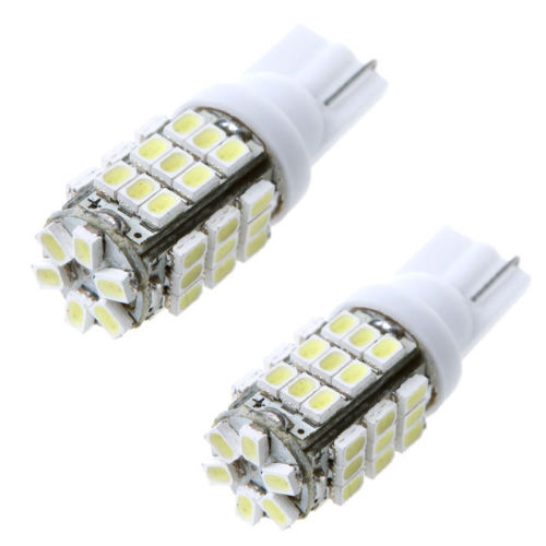

    White 1210 SMD 42 LED Car T10 W5W Side Wedge Light Bulb Tail Lamp 168 194 12V
    Features: Long-lasting LED chipsets with T10 Wedge Contact Base.
    Great for many applications around the vehicle.
    Replacement of indicator Lights, Reading Lights, License plate lights, Door Lights, Tail light, backup light, etc.
    Energy saving, stable performance.
    Green and enviroment-friendly products, safe and reliable.
    Compatible with T10 W5W 147, 152, 158, 159, 161, 168, 184, 192, 193, 194, 259, 280, 285, 447,464, 2825, 2921, etc(just for reference).
    Note: Please check the led light base type of your vehicle to confirm if the bulb will fit it.
    Specifictions:
    LED type: 1210
    Light color: White
    LED quantity: 42
    Connnect type: T10
    Voltage: DC 12V
    Lumen: about 210lm
    Item size: 3.2 * 1.1 * 1.1cm/ 1.26 * 0.43 * 0.43in
    Item weight: 5g/ 0.18oz

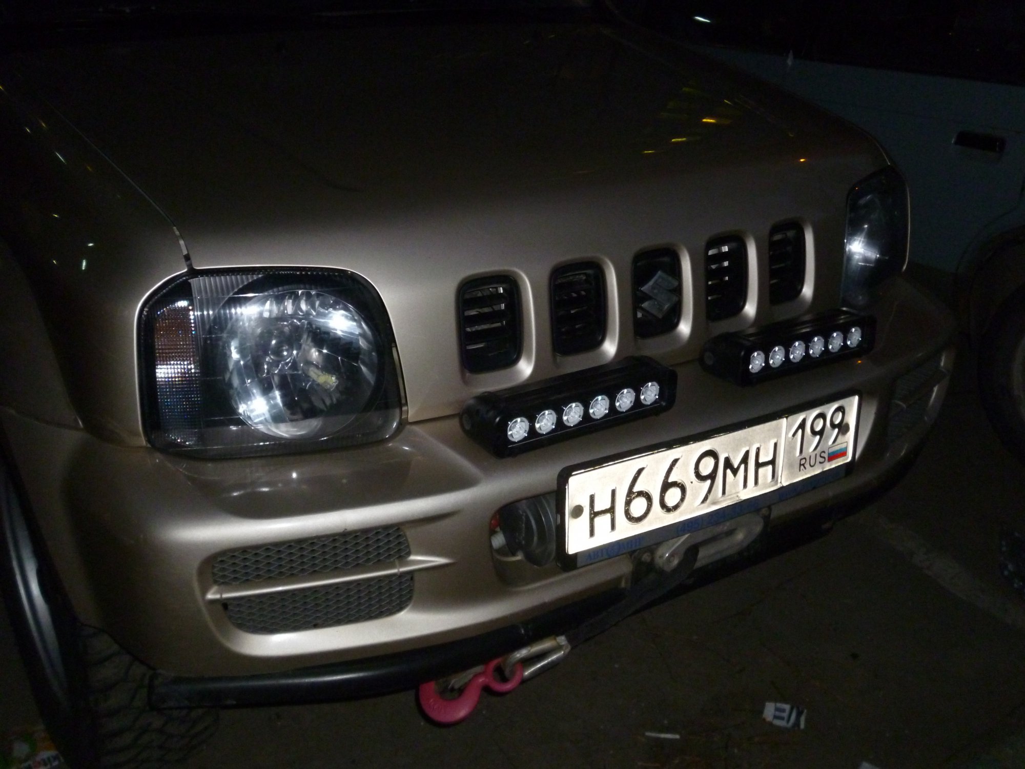

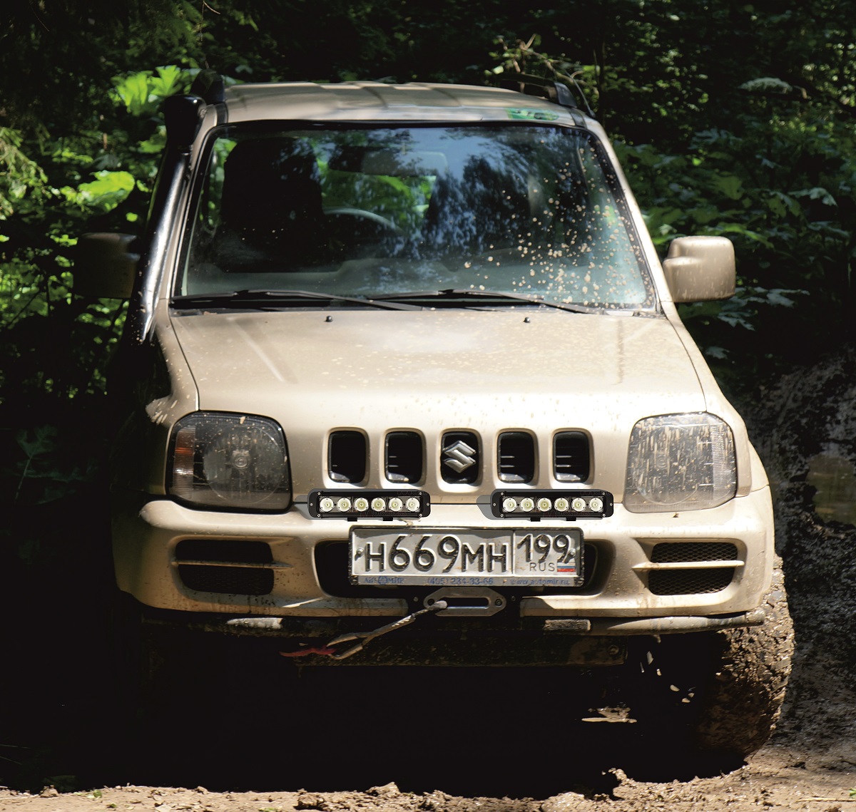

    Очередная идея выглядит вот так. Зазор посередине чтоб капот открывать. ( примерка в фотошопе )
    2X 11INCH 60W CREE LED WORK LIGHT BAR LAMP 5160LM 4WD OFFROAD SPOT FLOOD BEAM 12
    Думал над таким вариантом - стало жалко железо дырявить, а бампер и так весь перепиленный и родные кронштейны расчитаны на крепление вниз.
    2c0858bb-0350-3c75-aca2-506f7cc7718d.jpg e5847b1b-0c24-2aca-eb3b-f49600e5eafb.jpg $_575.jpg

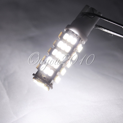

    Прислали White 1210 SMD 42 LED Car T10 W5W Side Wedge Light Bulb Tail Lamp 168 194 12V
    светят с фиолетовым отливом ....
    НЕ ПОДХОДИТ! НЕ ТОТ РАЗЪЁМ

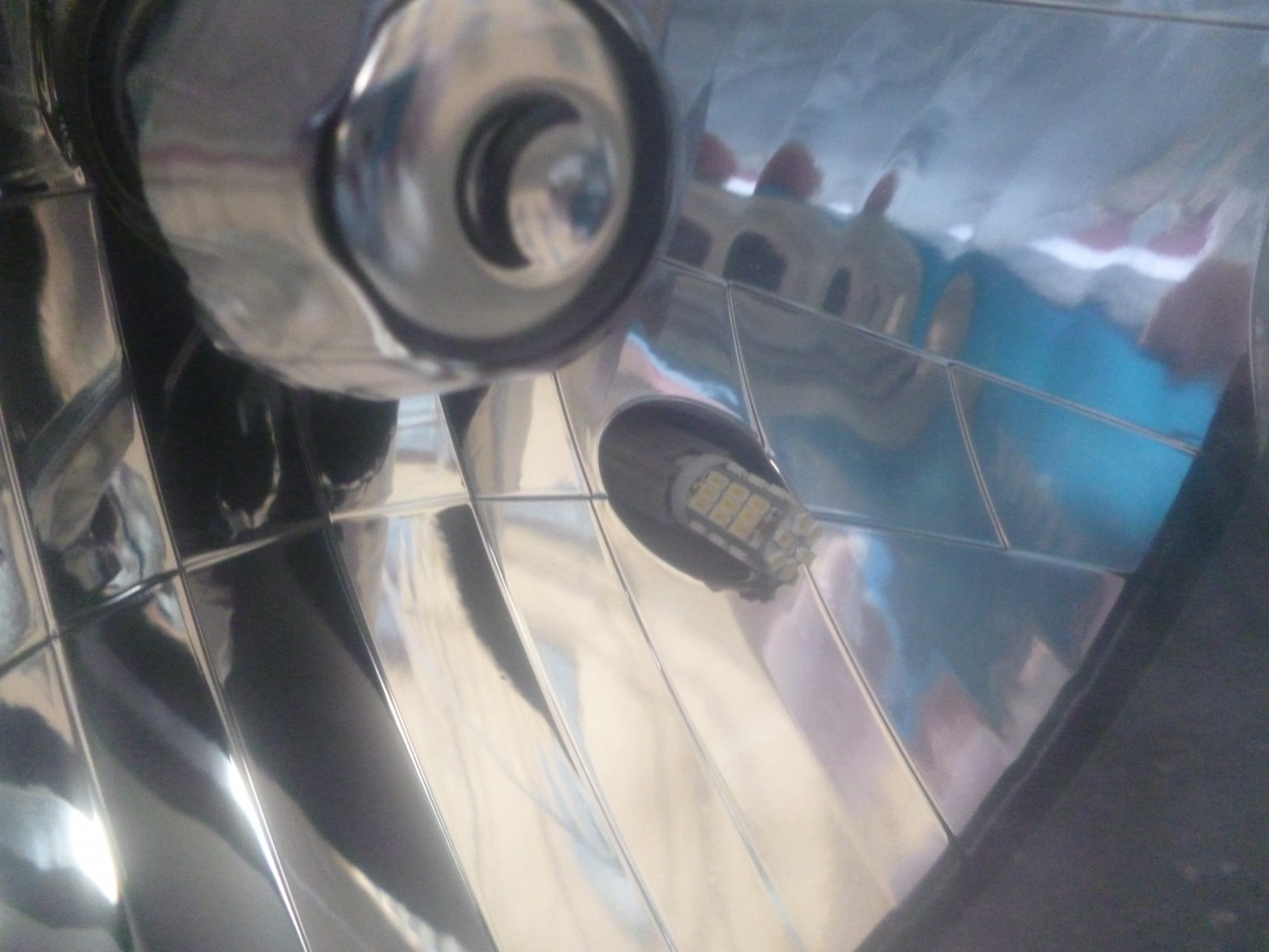

    ИТОГО: свет яркий, не синий, фара подсвечена целиком. На eBay копейки за мешок, только подождать 2-3 недели

    Зря заказываешь, полный порожняк. Светотеневой границы нет, светят куда попало, настройке не поддаются. Дальнего не будет в итоге, будет плохой ближний - сильно размытый, ярче, чем штатный, но всех слепящий. Гайцы за них вытебут похлещще, чем за ксенон.

    а балка и аккум слопает от души, да и по ширине или торчать будет по бокам или в самый обрез встанет..

    Не надо на бампер: 1)грязью заливаются на раз, 2) большой соблазн для пионеров и наркоманов. Купите поперечины на дуги на крыше: стоят полторы тысячи, ставяться-снимаются легко, питание подвести через дырку для антены на крыше, поставить штекер- собираешся в помпасы- поставил поперечину с приделанным светом, воткнул штекер.

    Дурацкая идея. И об елки снеси может и про пионеров тоже правильно. На мой взгляд, либо на крышу, как у всех или уж врезать в бампер стационарно, предварительно хорошо за герметизировав.

    А на джимнике моём стоит ксенон в линзах уже давно, полёт нормальный, свет отличный. Только лампочки дорогие ксеноновые, за 6 лет уже 1 раз менял.

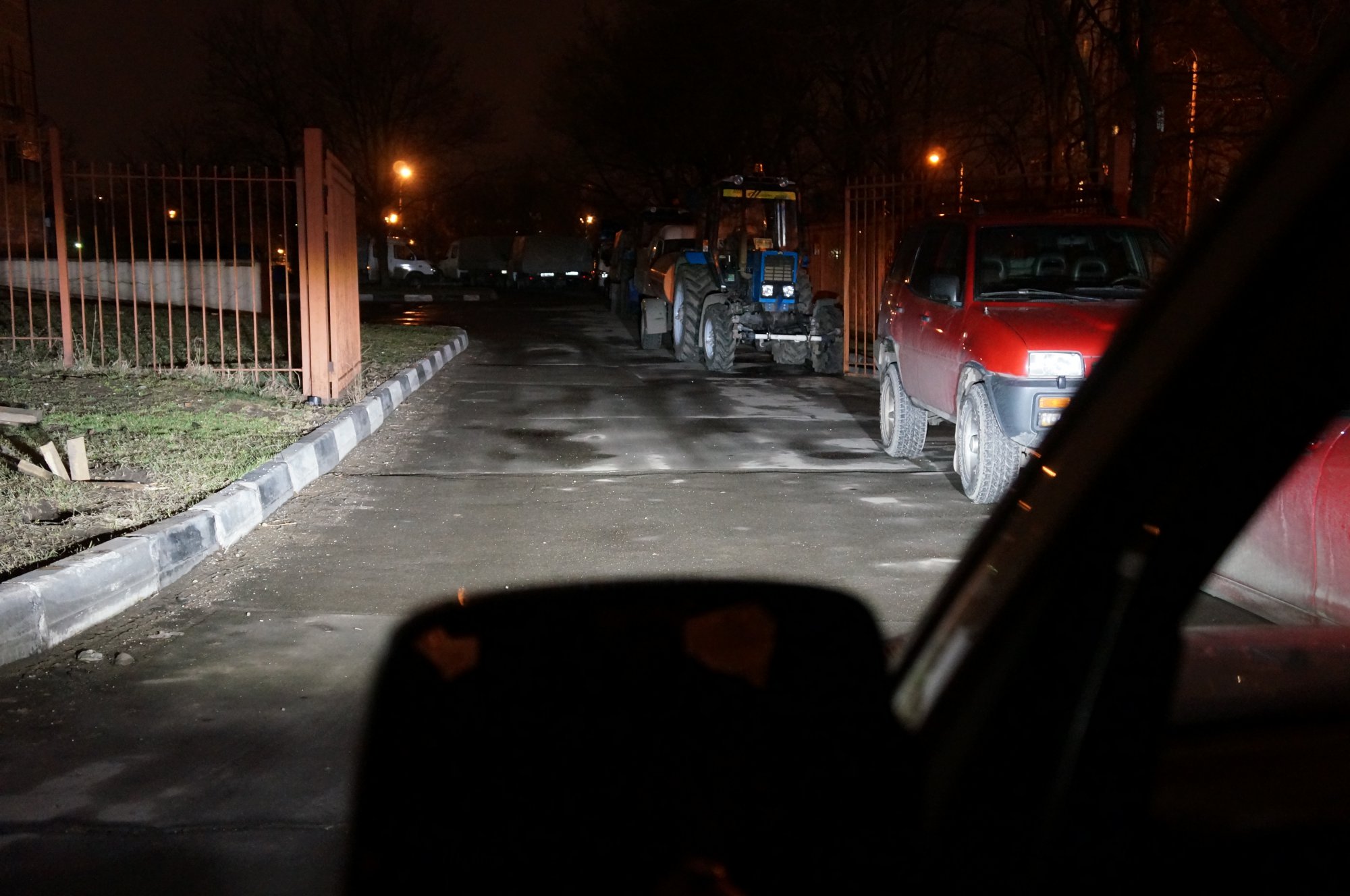

    только что вкарячил, ночью ещё не проверял

    Всем привет!

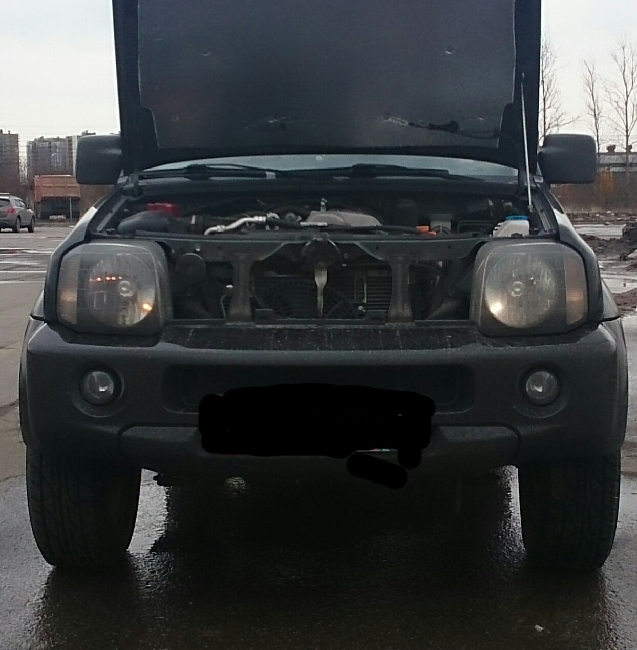

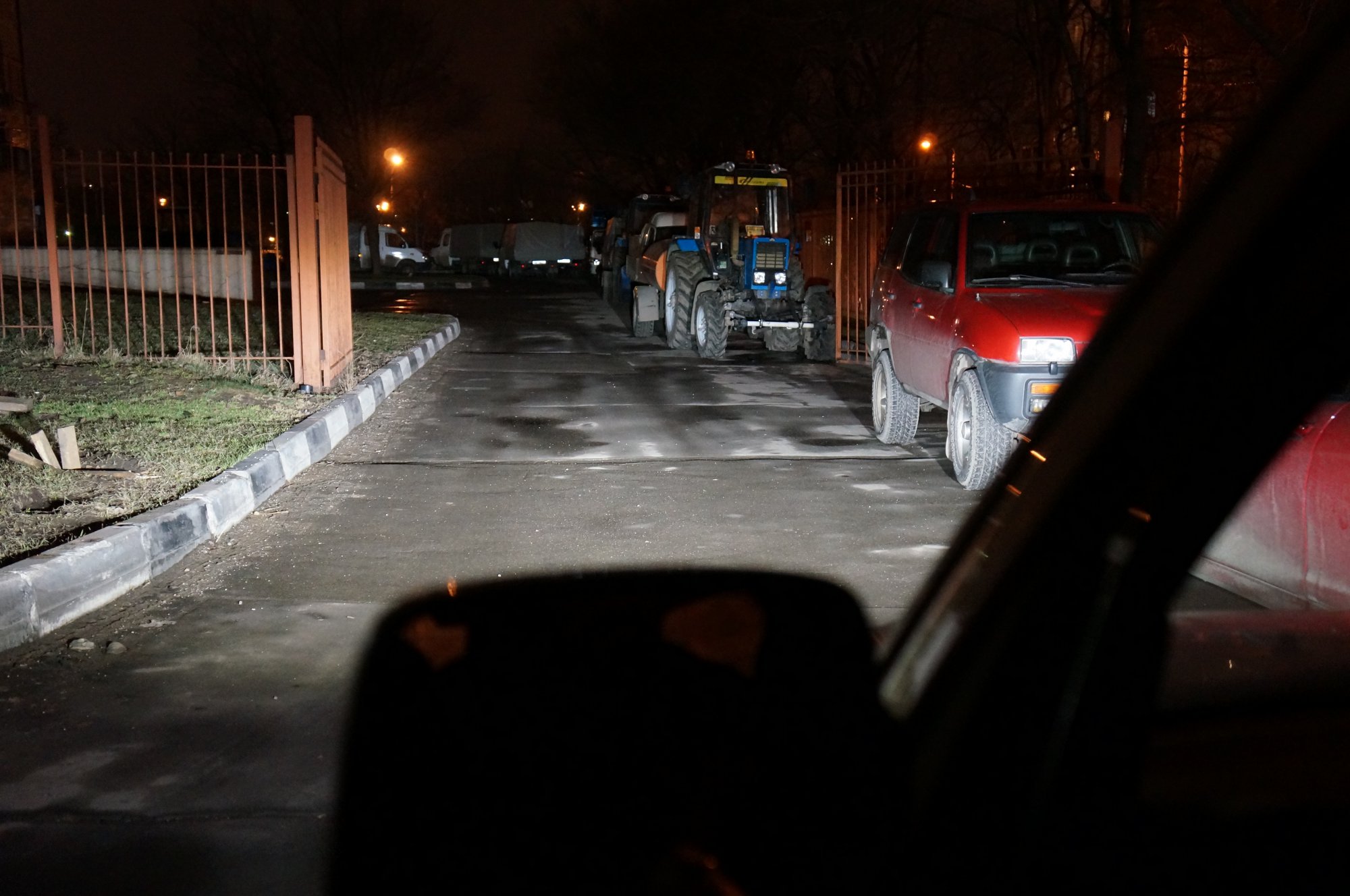

    Приобрел и установил светодиодные лампы osram 2850WW-02B(4000К) в передние габариты, получилось как-то так:
    #14 Desant, 22 мар 2014

    Два дня назад снял и выкинул LED из передних габаритов, все было бы хорошо если бы одна "лампочка" не жила своей жизнью. Вернул на место родные лампочки, теперь не нарадуюсь! Цена LED была без доставки 1700 рублей ...

    Цена osram 620руб,гарантия производителя на работу 5 лет,можно было купить Philips extreme, гарантия 12 лет, но непонравилось само исполнение, нет рассеивателя как на оsram.

    Я цену написал за две, покупал в инт. магазине, четыре диода по сторонам (на одной лампочке) и один через линзу с торца переднего - аж засмотришься, но сразу что то не пошло, претензий не предъявлял, сам дурак... рано еще такие вещи покупать

    переплатил как минимум в 4 раза! за такие деньги я бы даже и смотреть на них не стал. На eBay это всё копейки стоит и мешками продаётся с бесплатной доставкой.
    Воткнул я основные лампы в фары (ближний/дальний), ближним доволен, а дальний испытать пока не довелось... но у меня уже и "балки" на подходе (уж 10 дней как прилетели, таможат) - они и будут моим дальним :grin:
    Основная разница в том что "кукуруза" подсвечивает фару целиком, а не создаёт сомнительное пятнышко

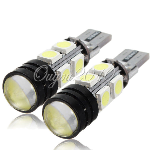

    заказал себе ещё и такие, хочу попробовать их как передние габариты в фарах ..... 235руб за две
    http://www.ebay.com/itm/281273561864?ssPageName=STRK:MEWNX:IT&_trksid=p3984.m1439.l2649
    2X T10 W5W 8 5050SMD CANBUS + 1.5W Q5 CREE LED White Wedge Light Lamp Bulb 12V

    Кстати осрам тоже освещает всю фару как лампа накаливания, но цена конечно дорогая....

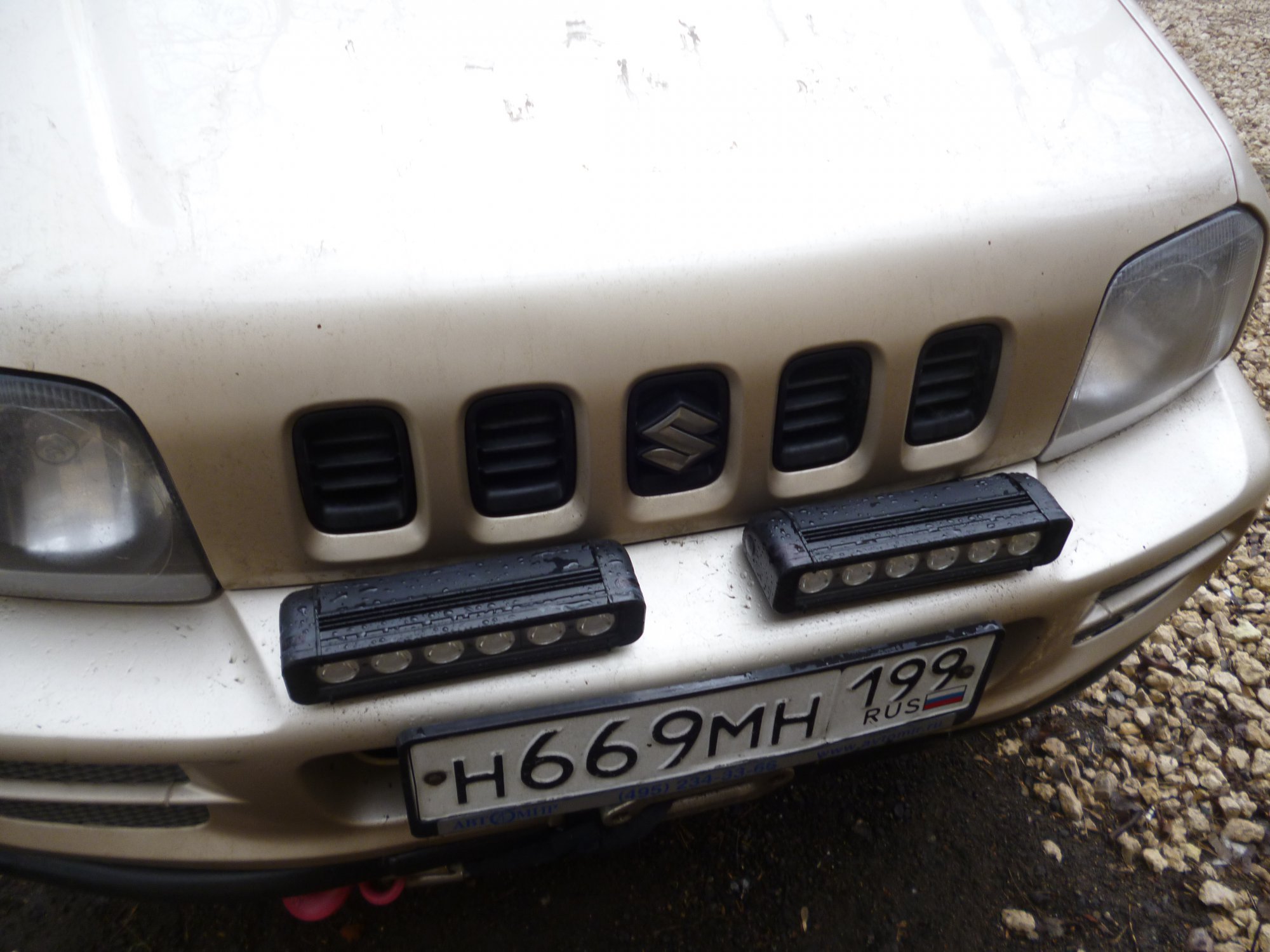

    P1020515.JPG P1020514.JPG P1020513.JPG P1020512.JPG P1020508.JPG В бампер сделал усилитель из 1,5 оцинковки и самопальные кронштейны ламп.

    При нормальной грязи и колее быстро забьются грязью. Слишком низко.

    Я так считаю, что мне они скорее нужны, чтоб в темноте не влететь со всего маху в ту самую колею с хорошей грязью... или какой нибудь пенёк... или с обрыва не навернуться... вариантов много, но главное быстрее ехать потому что видишь куда едишь.
    А ещё прикупил шкурку молодого дермантина, сделаю чехлы чтоб не засирались без необходимости

    Это хорошее место для дополнительного дальнего.
    Свкт для бездорожья должен быть сверху,потому что низкорасположенный свет засвечивает неровности, и не видно, небольшая ямка это или серьезная канава. Ну и вторая причина - устойчивость против грязи.
    Светят то как по сравнению с родным дальним?
  28. Pashk
    Pashk Crazy Lynx _______ (рысь бешеная)
    30 июл 2008
    435
    Москва-Кунцево

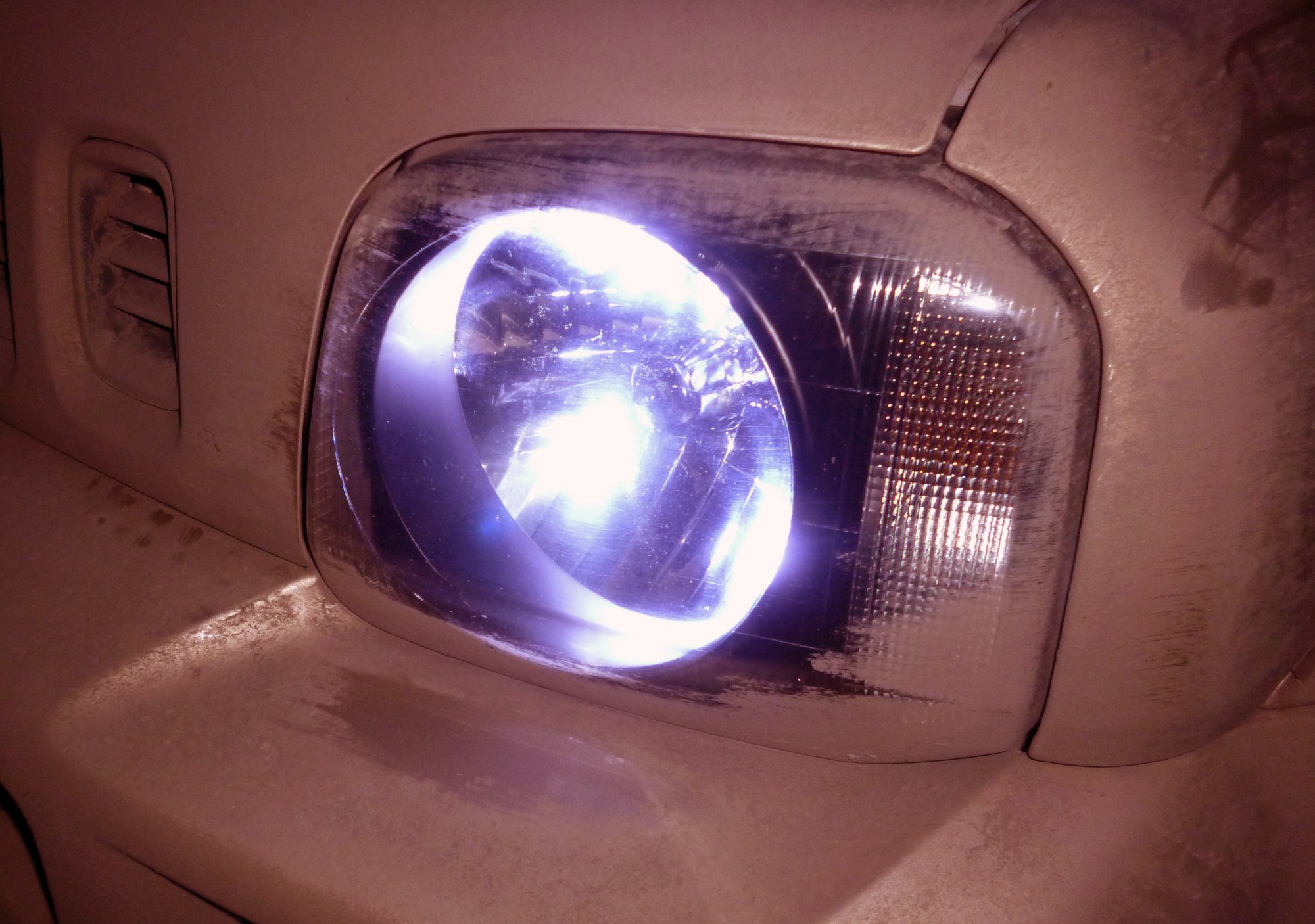

    Ну с родным уже поздно сравнивать...

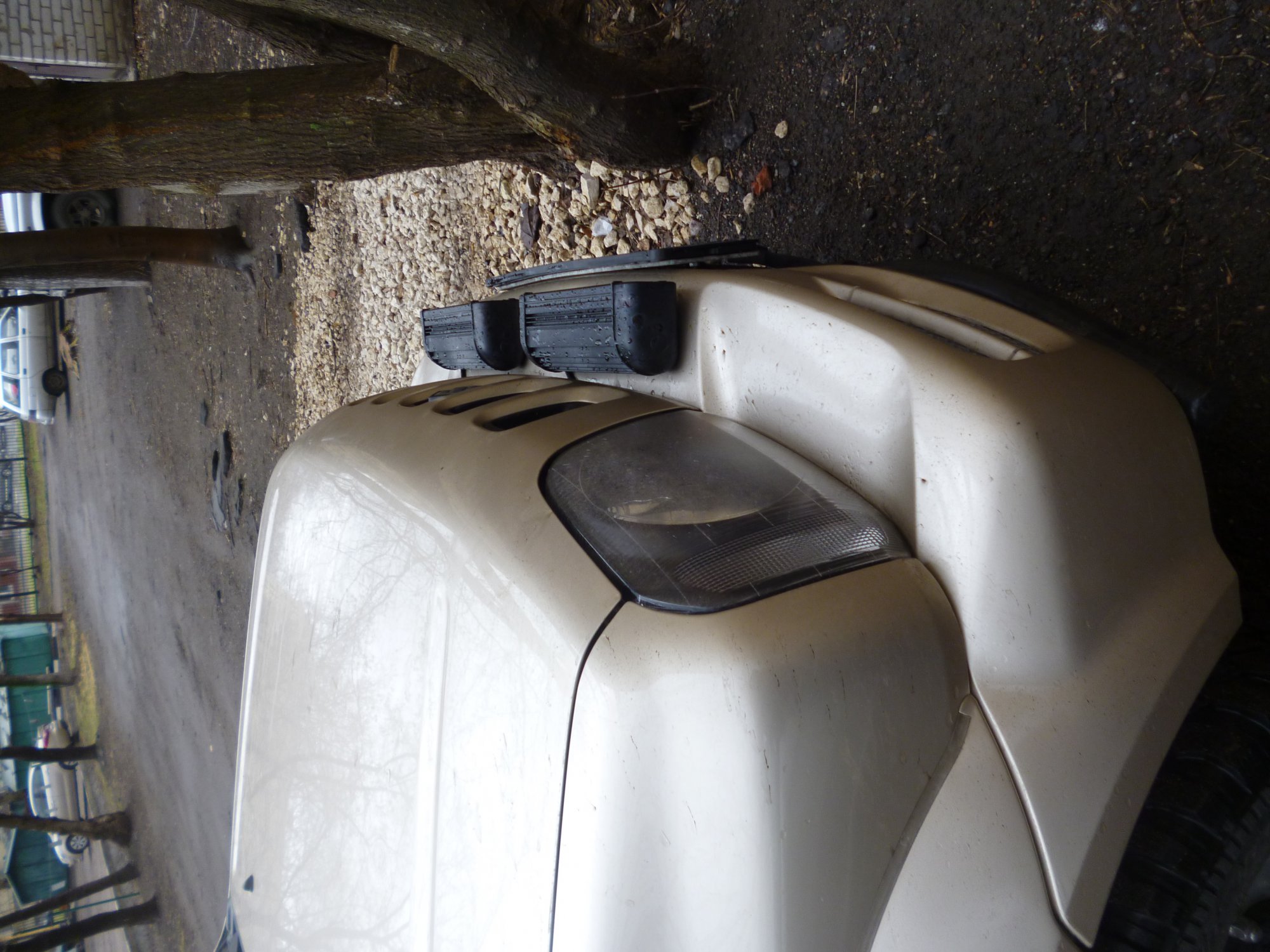

    ИТОГО: МОГУЧИЙ ближний от 1800LM 25W Car H4 CREE LED Headlight kit High and L...
    дальний почти без разницы, ну разве что повыше светит
    ну и 2X 11INCH 60W CREE LED WORK LIGHT BAR LAMP 5160LM

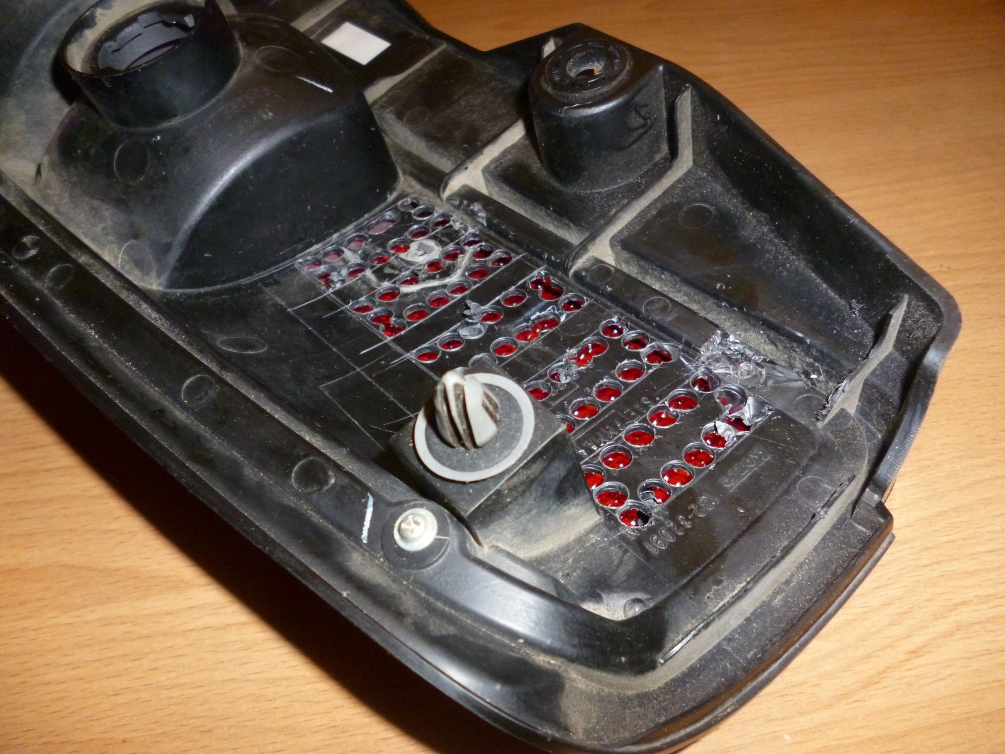

    а это по сути и есть дополнительный дальний

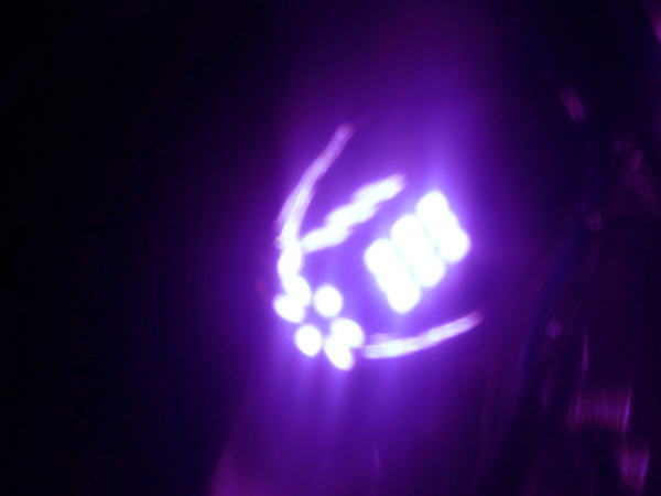

    Сделал дополнительную секцию стоп-сигналов. ОБМАН ЗРЕНИЯ = СВЕТИТ НЕ ЖЕЛТЫМ А КРАСНЫМ
    Сутра сфотаю нормальным фотоаппаратом...
    промежуточный момент = сверловка, забыл сфотать в собраном состоянии... прилеплял холодной сваркой "момент" эпоксилин мини 2в1
    P1020521.JPG Посмотреть вложение 56778 P1020523.JPG Посмотреть вложение 56780
