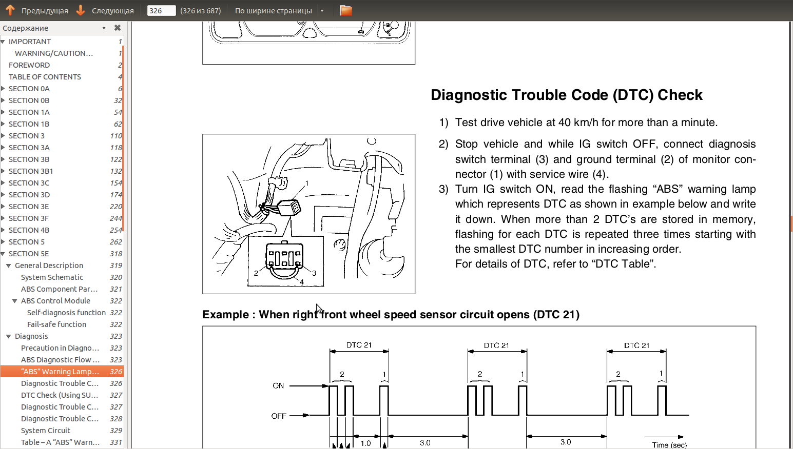

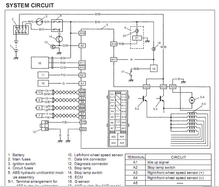

Мануал 99501_81A00_01E.pdf.
Раздел 5Е-14.
System circyit.
5. ABS hydraulic unit/control mod-
ule assembly
